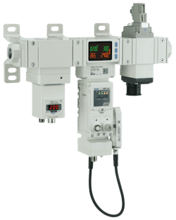

Smart point-of-use air management systems contain high-level features that can help a facility reduce costs. Energy consumption can be reduced by leveraging the unit’s digitized data, leak reduction methods and predictive maintenance capabilities.
The addition of digitalization has allowed onboard sensors to gather data, which is then sent to a hub installed on the unit. This data utilizes OPC Unified Architecture (UA) to communicate flow, temperature and pressure measurements used to establish baseline conditions for machines and other air consumers. This data is valuable for sustainability and predictive maintenance.

The primary areas to decrease energy and associated costs are air leak reduction and lessening internal leakage of system components such as cylinders and valves. The idea is to reduce pressure or completely shut off the air supply during machine idle times. Manufacturers install flow, pressure and temperature sensors, pressure regulators and shut-off valves at the machine point of use to measure and ultimately control airflow and pressure to a machinesaving costs (Figure 1).
With the digitized data collected, these sensors detect user-defined idle times during a machine cycle and automatically reduce the pressure controlled by an electropneumatic air regulator. During long-term idle times, a two-way valve is used to completely isolate airflow to a machine.
